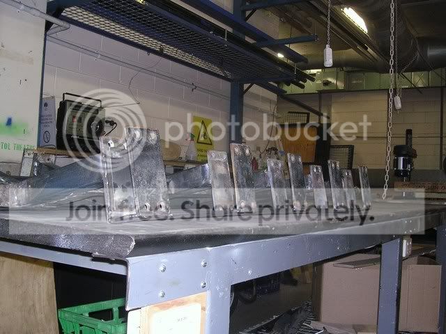

Mr Fatzook knocked up some tidy mounts

Post Posted: Thu Oct 04, 2012 10:58 am
Same mount with gussets...

Post Posted: Thu Oct 04, 2012 11:13 am
Some I made for Jason.

Post Posted: Thu Oct 04, 2012 12:32 pm
Bolts over the top of the chassis rail:
GBW:
Mine:
Your second CAD is pretty much what we've done, but that lower bolt hole obviously won't work.
