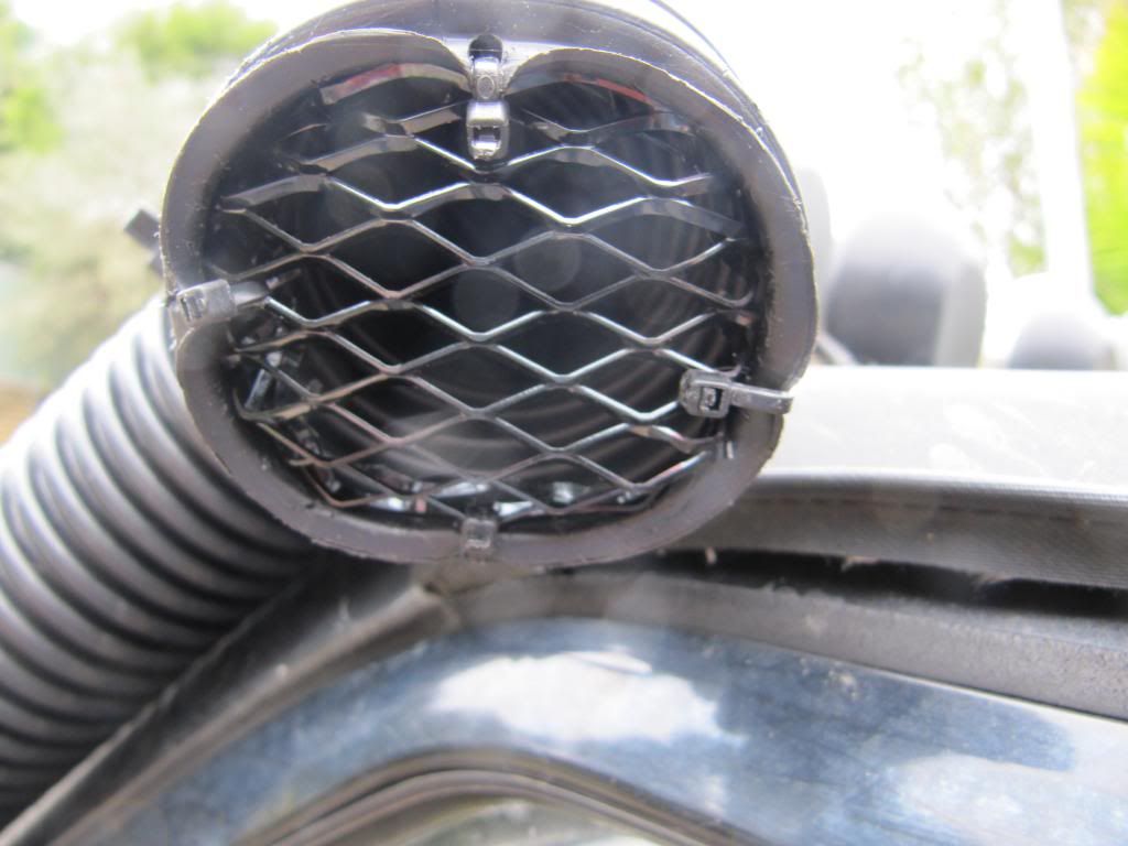

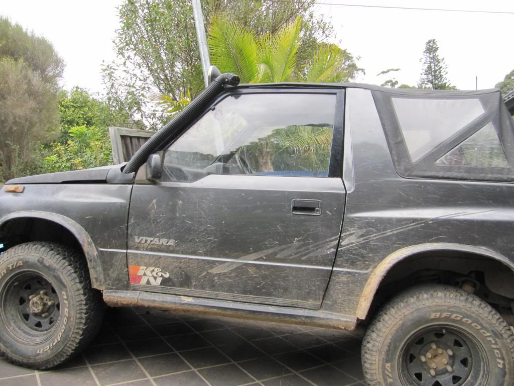

EDIT: forgot to mention a had to by 20 meters of the stuff and now have heaps left, if someone want to come and pick some up to make one for themselves feel free, i live at Terrigal, NSW
Was looking at making PVC snorkel because it suited my low budget, however i had heard some bad things about them such as exploding when hitting trees etc. Instead.. i did something cheaper but potentially more dodgey and went and bought some agg pipe from Bunnings. this is the result..
Just zip tied it to my light bar and added another 2 to put an angle on it to keep the rain out. put same mesh over the top to keep out anything else that might want to get in there

I wouldn't have snipped the tag off the cable ties cos then they would look proper dodgy.
haha, how bout i glue them back on?
Post Posted: Wed Jul 24, 2013 6:56 pm
As far as dodgey snorkels go it doesn't look too bad! How is it attached to the A pillar?
haha thanks. It's just held on with a cable tie around my light bar :oops: but i suppose it also means it wont damage anything if it gets ripped off. Was thinking of putting a couple of dabs of sikaflex down the A pillar to stop it moving around
Post Posted: Wed Jul 24, 2013 7:12 pm
where it goes through the inner guard, get some vacuum hose & run a cut along the length of the hose & slip it over the over the hole you cut in the metal so it's not going to wear a hole in the tubing.
good idea, i ran i good bead of sikaflex around it but vacuum hose would probably work better

How's it attached to the pillar?
Post Posted: Thu Jul 25, 2013 12:22 pm

Have you disabled or plugged up the warm air inlet on your air cleaner. Defeats the whole purpose if it can still get a gut-full of water from there.
yep, siliconed that sucker shut
