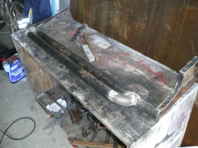

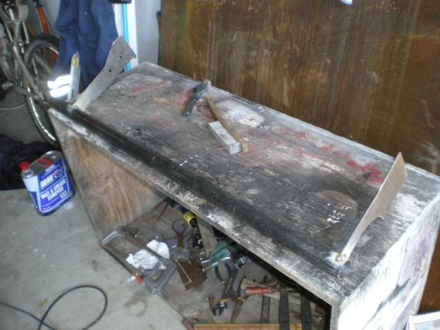

Well with the front bar and winch install done and dusted, sliders were the next on the list of things to do.
Started with a straight bar and brackets.

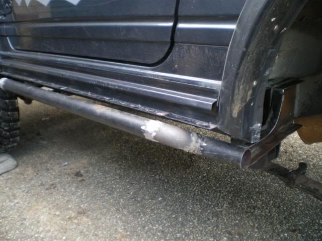

Rear Mount.

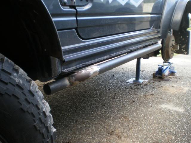

Sill bar in place.
Wing welded in place.
Bolted in place.
Just have to make a middle support bracket and the drivers side. Paint it up and I'll be ready to attack the rear bar.
Don't know whether to grind off the sill brackets or put the original side plastic sills back on. LTM wants them off.

It's a bit iffy on the I touch, but is that rear mount to the body as well as the chassis??

Mounted to the chasis only.
