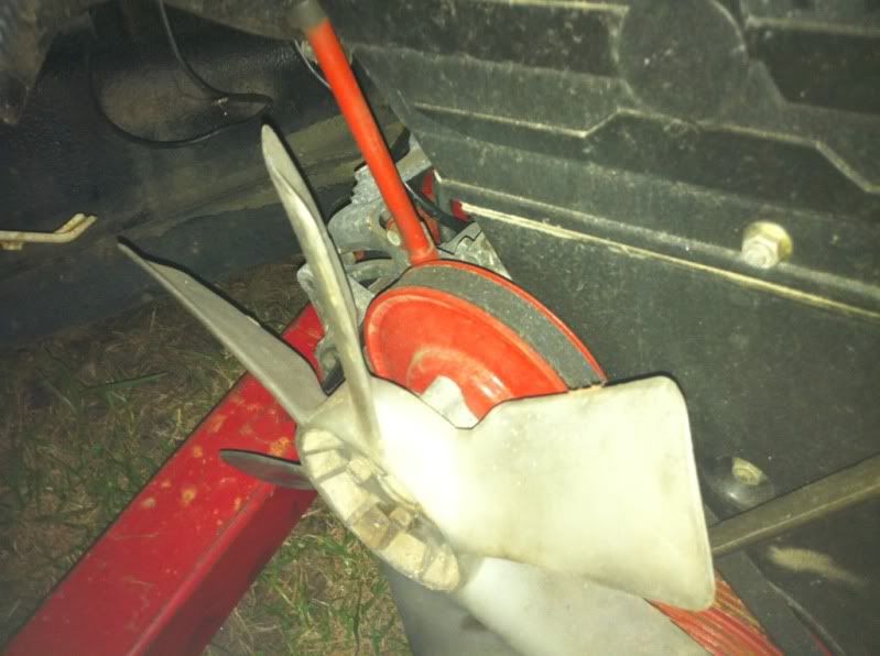

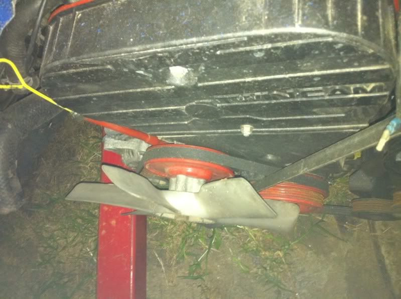

I got this w/p pully from santos he said it was of a toyota cant remember what model but it lines up with the std sierra water pump just needed to space it out with small washers as it sits to far back

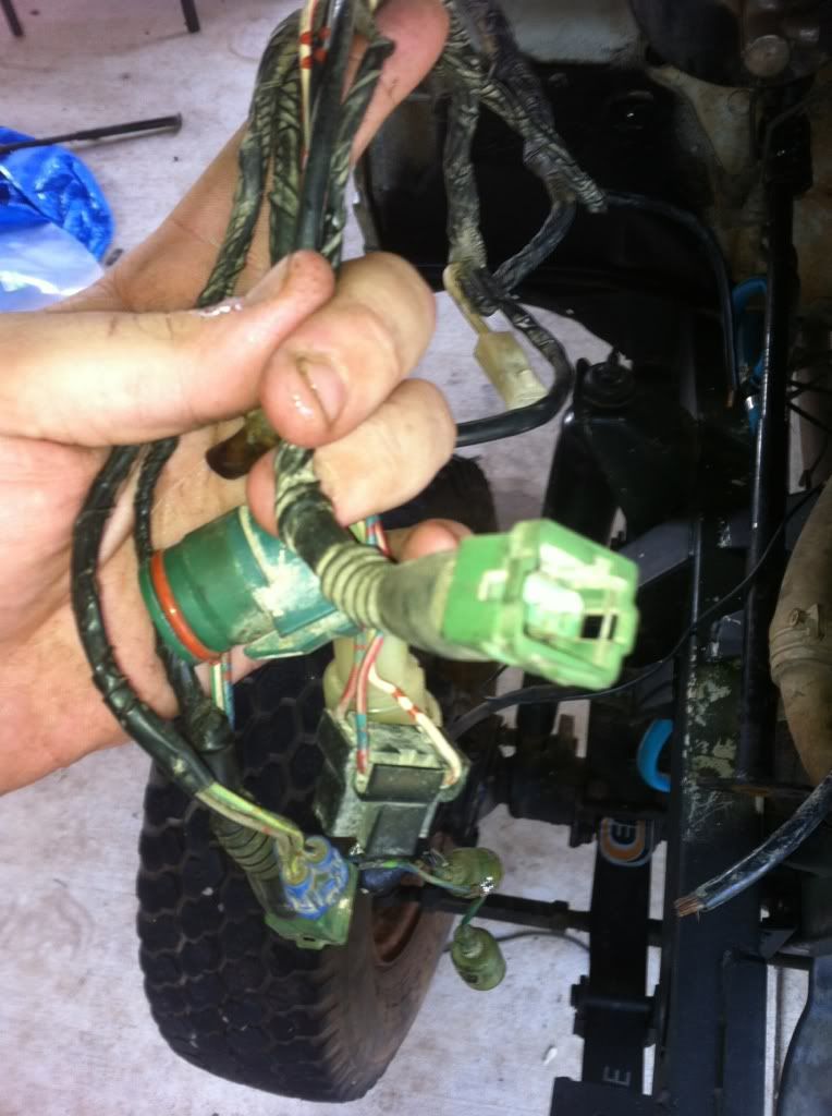

Also I no longer require this plus on my stock sierra loom due to g16b. Can I use this as the alternator plug? It fits perfectly and is two pin. This is for a 110 amp alternator. Will there be any problems involved?
Posts: 2070
Post Posted: Tue Oct 18, 2011 4:50 am
Pics help Image
It was the a vacuum solenoid thing on the old carbie motor.
