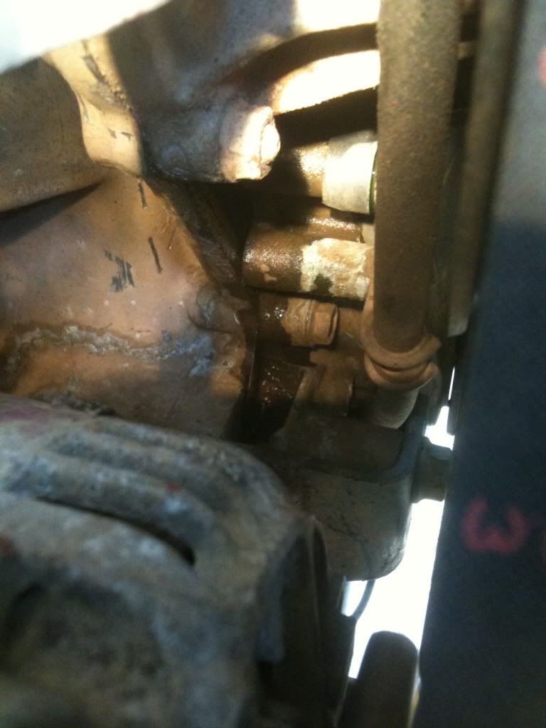

I tightened my fan belt the other night... And now.. For some stupid reason I am leaking coolant from somewhere behind there... :?
This is the best photo I can get of it.. And I am asking on here as I cannot get any closer to it than that..
The leak is quite extreme with it dripping out of there at about 2 or 3 drops per second...
I have a feeling that I may have bumped something when I was tightening the belt.. Any ideas of what it could be??
EDIT: I am asking this because I have never pulled apart this section and I don't know what is under there that could possibly be leaking.

water pump has had it, probably why the belt as loose
look up from underneath you will see the vent hole its coming from

Yep, it's stuffed and needs replacing.

thats him
