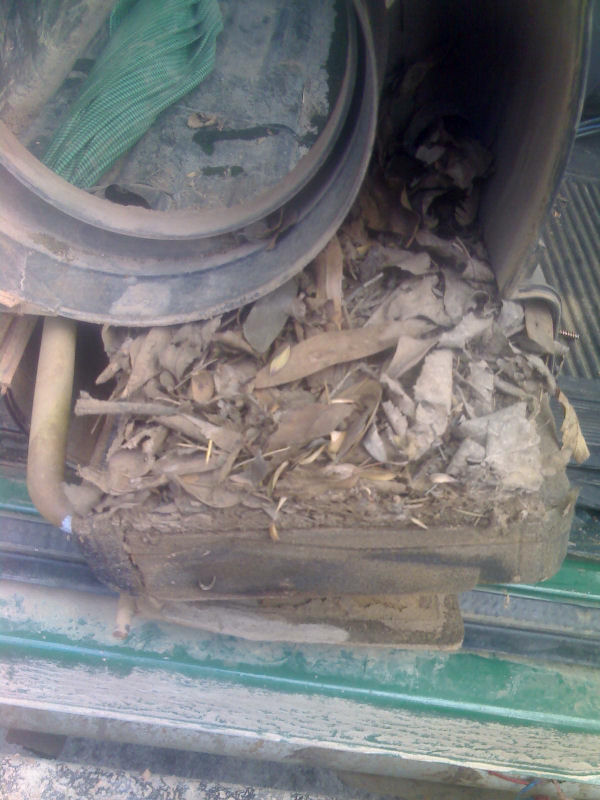

Post Posted: Sat Apr 24, 2010 3:27 pm
Here is the crap i found in mine when i did it. There was zero airflow.
A few hints and tips when you remove the heaterbox:
There is a single bolt/screw holding the heaterbox that you access inside teh engine bay on the firewall, took me about 15min to work that one out lol.
The heaterhoses will be a bastard to detatch from the heater core at firewall, you can either be paitent and work at it without damaging the thin walls of the heatercore pipes, or just cut the hose with a knife and replace the hoses with new ones. You really should be replacing them anyway if they havent been done since new.
Take a photo of where all the mechanisms go (yours is detatched i think you said anyway, so you may need to look at a mates car).
All or at least most of the foam will propably be degraded, you can buy this stuff i strips from Clark Rubber or Bunnings so thats no problem.
Anything else i missed Damo?
Post Posted: Sat Apr 24, 2010 6:14 pm
I think you have it covered PJ!!!!
BTW, did you get any spuds out of your airbox 8O
