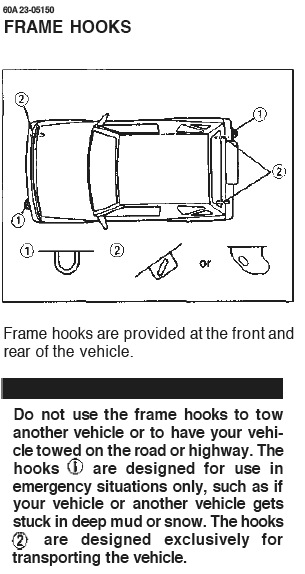

So I found out that what I thought were my recovery points just to be tie down points.
After visiting a 4wd store, I found out that there is not suitable spot for them but to check with the suzi store.
They said that people make their own and did not make them at the shop.
More research and some have said the tie down points work if you use more of a tow rope and not a snatch strap.
BUT I still need them due to the 4wd club i want to join, it has them as a requirement :/
So what have fellow auszookers been doing to solve this problem? Do they know where I can get them made for me? I could get a new tow bar and bull bar but that is way out of my price range.

There seems to be a lot of confusion over this issue, the hoops are recovery points, the slots in the chassis are the tie down points:
Do check the that the chassis that the recovery points are fixed to is still sound, especially on the rear.

I will have to have another look.
These were what I thought to be the recovery points but was later told they were just tow points cause if i was snatched off them, they would tear off my vehicle.

I have recovery points built in to my winch bar now but if I was still using the original hoops I would be running outside now and running a bit more weld around that join.
I don't think Suzuki were intending them to be used for snatch recovery.
