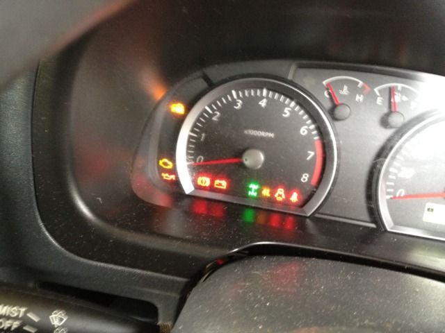

Ok, i've sort of got the 4wd light working. The "4L" has stopped flashing with the jimny sensor in the case when ever your in 2wd, 4wd H or 4L. The green light still flashs all the time, until you engage the hubs. The light is just a solid green then, no flashing. So i'm not sure what i need to do to get the green light to stop flashing....
Post Posted: Sun Mar 04, 2012 9:41 pm

I figured out the wiring today. I cut both the red/blue and the red/white under the dash at the AISIN controller. The wire stubs at the controller can be blanked off. The lights will now be off completely.
Join the two other ends of red/blue and the red/white together, join to a single wire and run to the transfer 4WD switch (under car). The other wire of the switch goes to earth.
Unfortunately the transfer switch is not two stage so 4LO and 4HI can't be differentiated. I chose to have 4LO light at the same time as 4. If you prefer just 4, leave red/white out of the join under dash.

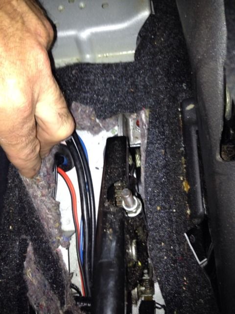

OK, all done.
These two wires. Red/blue = 4WD, Red/white = LO. The two wires left dangling on the AISIN control module can be blanked off.
I spliced both together so 4WD and LO both light at the same time even in high. If you don't want LO don't splice in the Red/white but you'll still need to cut it to stop it flashing.
Also in this pic you can see the earth wire running to the steering column bolt/nut. Used a dual wire connector just in case I want to easily disconnect.
I ran dual core so the earth could be in the cab instead of more wires dangling underneath. passed it through the same grommet that the standard transfer wiring loom passed through at the rear of the handbrake.
Finally tidied up the standard wiring loom
Used a waterproof dual wire plug so I can easily disconnect when I need to remove the transfer case
2WD and Neutral
4WD Hi and Lo
