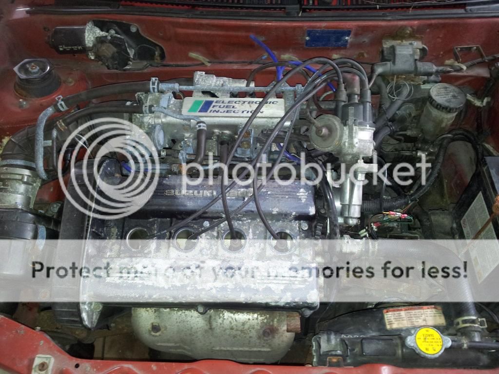

finally mounted adapter:
adapter on engine:
angle drive:
mounted in a gen 2 Swift:
everything Works, but I got no spark.
when you see the pictures below, you'll see why :/

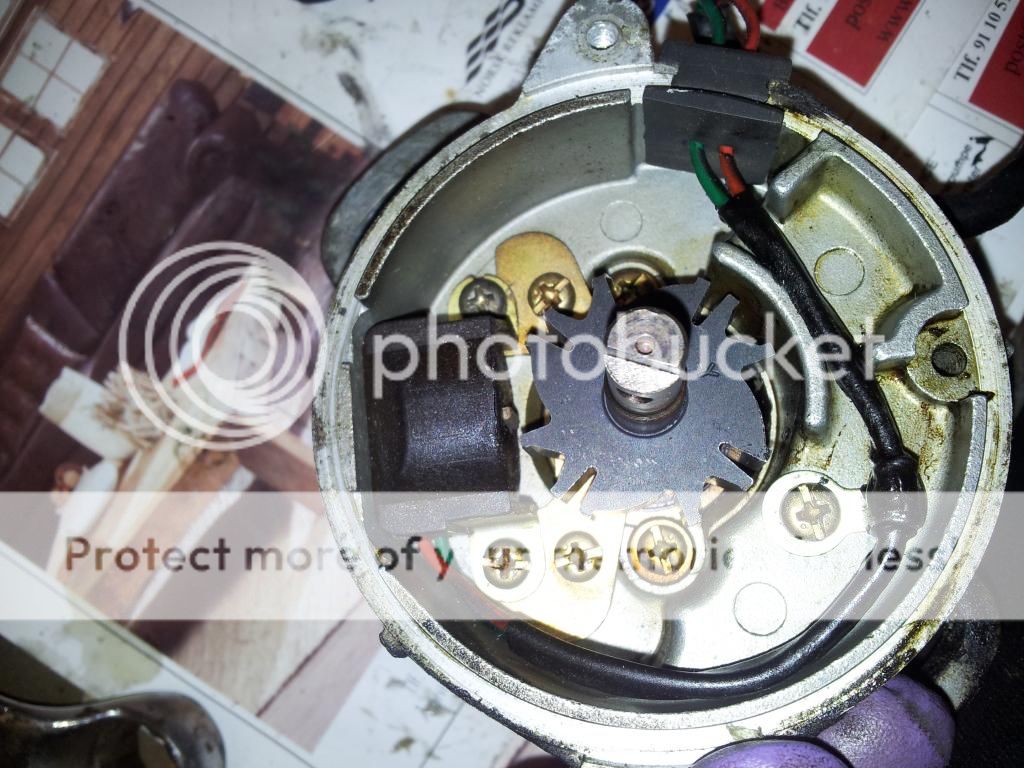

samurai distributor:
V.S
Swift gen. 2 distributor:
there are two different ignitor systems between samurai and gen. 2 Swift. But if I had a spare gen. 2 distributor, I'd just put it in the samurai disrtibutor and the problem would been solved, but I didn't want du destroy my only gen. 2 distributor.
as far as I can see, samurai and Swift gen. 1 distributor, got the same Components inside the distributor, and therefore it should work witout any problems.
unfortunately that means that I'm not able to test run my angle drive kit.
if anyone got any ideas of what I can do to test my kit, I would be really happy!!!

Post Posted: Mon Aug 18, 2014 8:25 pm
If you get a reluctor wheel laser cut to match the mk2/3s and mount it to that dizzy shaft it will work

But isn't the issue that the Gti Dizzy turns clockwise and the Sierra (and Vit) dizzys turn anti-clockwise? The reluctor wheel could be copied in a mirror image, but the reluctor coil might not give the correct signal if reversed. (Dunno if it's a simple magnetic field pulse, or if it makes a wave form signal for the ECU.)
Post Posted: Mon Aug 18, 2014 11:12 pm
Good point 303!
That being the case then the reluctor wheel must be flipped to retain the correct angle pulse sequence for anti clockwise rotation. If the sierra/vit pickup coil is used then the wiring with give the correct polarity to the ECU ie red to red and white to green. However, if the mk2/3 pickup coil is used the wires must be swapped to give the correct polarity to the ECU ie red to green and green to red etc

To get the distributor to work properly is the next case. The mk1 and samurai has the same Electrical components. Mk 2/3 is different. I gues you'll have to use the mk 2 / 3 Electrical comonents in the samurai distributor housing.
about the rotation, its something I'll have to figure out. the only problem I've got is that I don't have a running MK1 yet, so I can't test it out properly.
so if anyone could help me solve this problem, it would been great!!
