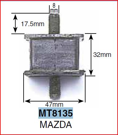

Post Posted: Tue Feb 10, 2015 9:33 pm
i've had a lot of dramas with broken mounts since fitting my 4.16 gears. first time in low range, driving in my front yard, i snapped the mount. barely even under any load... replaced it, next one broke first time offroad... replaced that with a mazda engine mount (i'll get the part number, its about 5mm taller but much wider therefore stronger), that lasted 3 trips, but definitely much stronger than the stock mount. i have a new standard mount in there again, supported by a ratchet strap. it still has some flexibility and movement (as they should with rubber mounts) but only to a certain extent. dodgy, but it works well.
Edit: part number is MT8135. more info in said link: viewtopic.php?f=5&t=9309&hilit=transfer+mount+mazda

Post Posted: Wed Feb 11, 2015 8:53 pm
Trying these mounts as the factory ones were stretching under load, transfer would bounce and flange was hitting the cross member?
