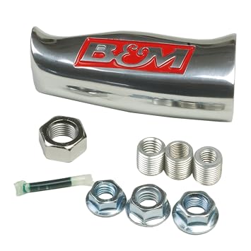

Post Posted: Sat Mar 14, 2015 7:18 pm
I have a B&M shift handle on mine, it screwed straight on. Listing for it say it's 1/2in-20

Update - the size is definitely 1/2in-20.
Bought a BM plastic ball shifter and fit straight on. Thanks!

As Tony said, 1/2-20 is very close to 12mm x 1.25

I said 12mm x 1.25, as a 12mm x 1.25 bolt fits into a 1/2-20 nut without binding.
