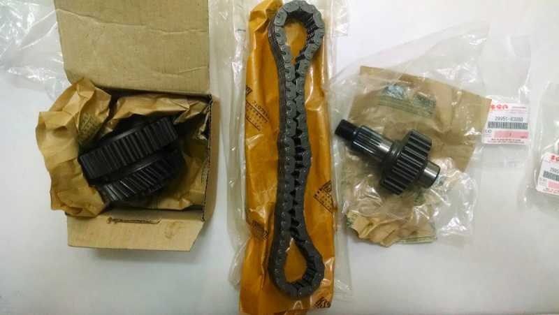

Post Posted: Mon Jul 28, 2014 7:27 am
top jimny wrote:
but it's about 30% reduction 8-P
yeh some say its only 27%, but if you do the maths based on GPS speeds and engine RPM (two controlled outputs of standalone systems) you get closer to 32%, which is what the manual says it is anyway...

Post Posted: Mon Jul 28, 2014 10:20 am
Rhinoman wrote:
top jimny wrote:
Just FYI a reduction gearset can be put together by using gears and chain from an Auto VVT into a Manual VVT without changing the whole box. Suzuki are selling this kit here in Brazil, but it's about 30% reduction 8-P
Have you got the part numbers for those bits?
Whats the difference between this and swapping to an Auto box?

Post Posted: Mon Jul 28, 2014 11:59 am
you dont have two boxes, one in the car and one on the shelf.
you have spent similar money, have less redundancy (dog clutch +planetary set) and have your old 1:1 gears in a bag full of gears, chain, oil and grease somewhere safe, but you cant remember where 'safe' was.

Just to reiterate...
The chain in an auto box is about 5mm narrower, so will stretch quicker.
Count the gears on the 2 gears of the set. In an Australian auto Jimny, this works out to be 1:1.27 and 1:2.54 (27% reduction from a manual).
