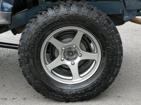

So my 30/9.5R15 Maxxis Mudders are getting pretty light on for tread, so i'm wondering (after seeing these www.cl-link.com/photo/66_5.jpg ), what would be the pros or more importantly any cons for going a tyre in a 215/85R16? These are equivelent to a 30-31/8.5R16. I know they're pretty skinny, so obvious disadvantage on sand, but my main driving is mud and rutted fire trails. I want my zook to be a bit different, so a departure from the usual 'fattest tyre possible' trend is a definite option. I've found a cooper Light Truck tyre in a At pattern in this size and I know that their tyres are great quality.
92 Sierra Hardtop, 2" OME Lift, 30" Maxxis Mudders
Post Posted: Sun May 09, 2010 1:49 am
its a very good idea... think of a tank when you think of tyres...
40+tons of steel on 2 skinny tracks... its the length of the tread that provides you traction, not the width. When you air down a tyre your aim is to increase its length on the ground giving more tread to grip it.
Now consider - what brands are available in that size and are you happy with those tread patterns?
I engineered mine for 31x10.5r15 as its a common size and very available, it was also the biggest i could go with WA's stupid laws (which are now worse). My next set will most likely be 32x9.5 swampers.

A mate runs a good year wrangler in a skinnier size on his tourer an absolutely swears by them..
He is doing all kinds of terrain and says they are perfect on everything.
215s are farely thin though.. I would look for something a little wider .. Maybe a 225 or wider again as the tread pattern tends to get tight with smaller sizes... So less self cleaning

a skinny tyre is a good idea tho as it will just cut through the mud and not just hit and sink bering in tassie mud is our main tracks so it would more then likley work better for u

I'm a big fan of skinny tyres for the reasons outlined above ( but did you know skinny tyres are better on sand that fat tyres?) however, I don't think I'd go with 215's. They're an uncommon size, so you have a limited range of replacements, and also check their load rating- lots of narrow 16's have sky high load ratings that don't conform well on a Sierra.
Personally if you are going to narrow 16's I'd step up another inch to 7.50 16's or 235 85 16- more tyre availability and a bit longer footprint.
