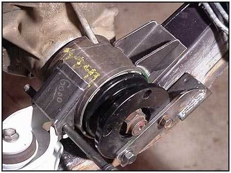

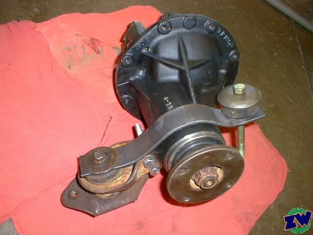

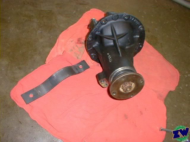

Christover, i'm not sure if you've seen these photo's around the traps but they might give you another idea. the "collar" would work better with the sierra carrier, where as the "strap" would work if you were running the vitara carrier.
i missed this update, here are a couple of pics showing the early & late mounts.
late model
early model
this link shows how much the sump on the SV420 (2.0L) needed to be adjusted to get the late model pinion mount to work, i'm not sure how much clearance there is on the 1.6 SE416 vitara's
http://auszookers.com/index.php?name=Fo ... 639#128639
from this thread http://auszookers.com/index.php?name=Fo ... ic&t=12677
EDIT: the 1.6l vitara does not need the speed dent in the sump to fit the later GV mount in the 2nd to last link
