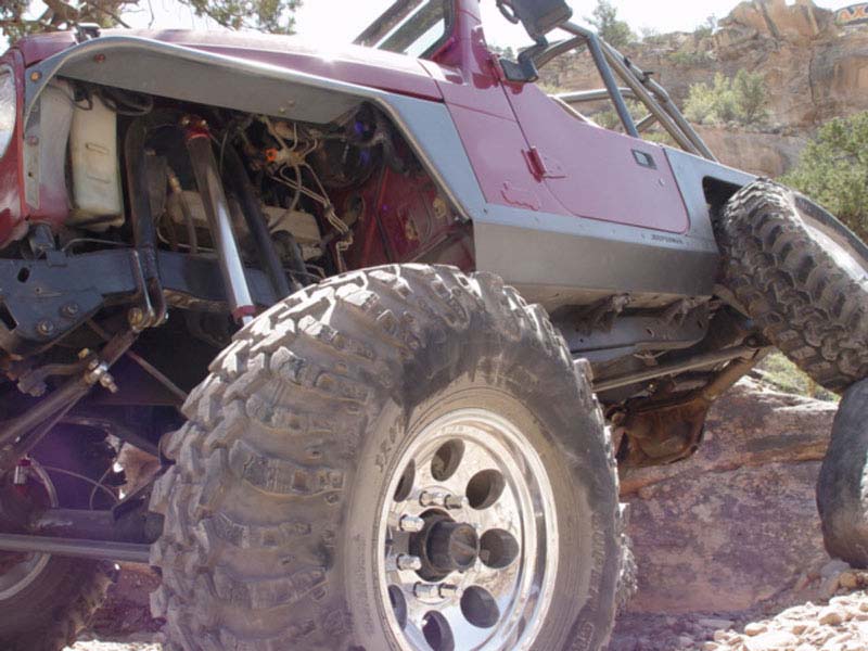

as some of you may know i have a way of letting nature take its course in increasing my sill clearance....rocks have mashed my sills. so its time for them to go. i have seen a few people do it, eg "swifty_ano" using some 70x50 RHS ( http://www.auszookers.com/index.php?nam ... 9&start=30 ) and RIKSTR and his C section ( http://www.auszookers.com/index.php?nam ... sc&start=0 )
but my question is, is it possible to use 4-5mm flat bar once it has been chopped off? will i have any issues in welding in the inner side (something to weld to)? and will i have any issues legally with cutting it off?
this is where i plan on cutting it.
this was taken from rikstr's thread: this is what i want to do but cut the back off as well, then put the flat bar in. understanding??
this is what i want to achieve, but without the slider and the inner wall of the C section.
hope this makes sense, any help would be great. im doing this to increase clearance and to make it looks a little better.

Hope ur a great welder because suzuki panels are like tin cans
I would cut the bottom off and neatly fold the back up into the sill then the front over that then weld it up
Then u can make what ever slider u want to sit below it and fix it to the chassis

if you take it all out and just put 4-5mm flat bar in there with no sliders i think your doors will start to look pretty average.
lseries 2" body lift king springs 27" boots and a
Joined: Sun Apr 26, 2009 11:30 pm
Posts: 1278
Post Posted: Wed Jan 11, 2012 8:24 pm
if you dont put a slider in the gap you will just bend the door
Post Posted: Wed Jan 11, 2012 8:37 pm
Flat bar has no strength in it
It will just bend
U need some thing with some profile to it
Try 25x 50 or 25x75 box

You can use flat bar just make it 12mm or thicker and brace the fuck out of it

Curving inwards like a side of a boat.
Good for slipping over things, rather thasn getting hung up
Post Posted: Fri Jan 13, 2012 6:18 am
Joe wrote:
What's boatside mean? :oops:
to taper/angle the sides like a boat.... :wink:
like this:
\___________/
instead of like this:
|___________|
usually it's a bit more drastic than just cutting the sills, some even chop the lower section out of the doors to boatside it even more.
Post Posted: Fri Jan 13, 2012 6:21 am
Posts: 13007
Cutting the sills up at an angle.
These are radical examples, but it shows the effect.
In some cases, the bottom of the door is cut, in others, it's all under the door.
The idea is to provide a smooth, angled face rather than a square slider that gets hung up.

how structural is the sill? i realize that theres a full chassis under the body but is the sill part of the cars structure?
basically i've cut mine the same as this to fit chassis mounted sliders, do i need to reinforce whats left with some 3mm or something or can i just seal it off with some sheet metal?
Post Posted: Sun Jan 15, 2012 2:13 am
theyre only structural if you dont have a slider there to take the beating =)
fancy control arms too!
Joined: Sat Mar 26, 2011 8:45 am
Posts: 1602
Post Posted: Sun Jan 15, 2012 3:51 am
the pics from rikstr's build.
next question, how much gap should i leave between body and slider to allow the body to flex on the chassis? 2-3mm?
Post Posted: Sun Jan 15, 2012 3:56 am
i'd say it's structural & you need something like a large piece of angle or a piece of box section as the A & B pillars have now lost the little bit of box section rigidity that they had with the fromed sill panel section.
