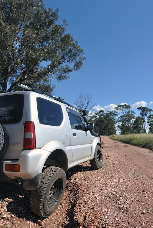

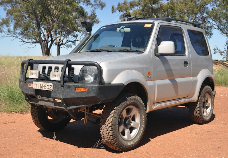

I'm running a tough dog 3" lift and BFG 215 A/Ts.
Here's a few pics...
Just after installing the lift, still on stock alloys.
Next day, same 215s but now on 15x7 rims with a neg 13 ish offset.
