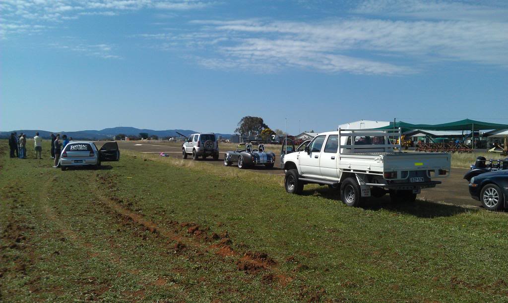

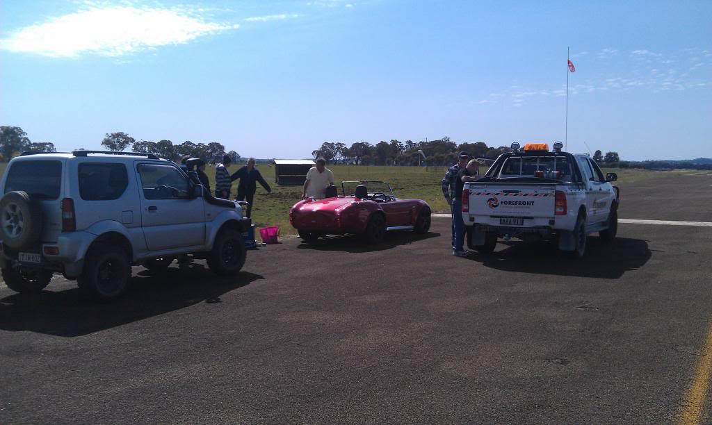

Treeve does all his testing together, lane change tests, brake tests, etc and on a whole range of cars. I think he runs 1 or 2 test days each month and they are done on the runway at Cudal airport.
Here's a few pics from the test day:

Looks like the Mirage Failed the test :)
