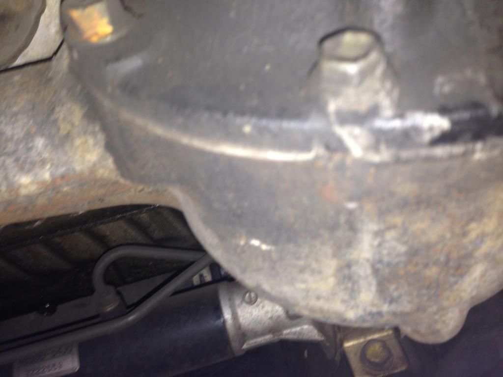

Hey guys, all the info I read on this site tells me that my 2004 auto sq625 GV has an alloy front diff, however when i use a magnet to test if it's alloy or steel it sticks the the entire diff housing making me think it is steel. Can anyone help me out by telling me if the 2004 GV sport auto 2.5 has steel or alloy front diff.
Post Posted: Sat Mar 22, 2014 4:01 pm
At some stage Suzuki did put steel diffs in the autos. I think it was when they did the interior update in late 2003.
But they also did a complete design swap at some point. Take a pic of your diff and show us as much detail as possible. it will help us determine if your diff is able to take a locker or clarify when the change took place

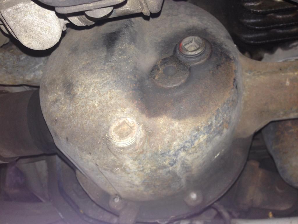

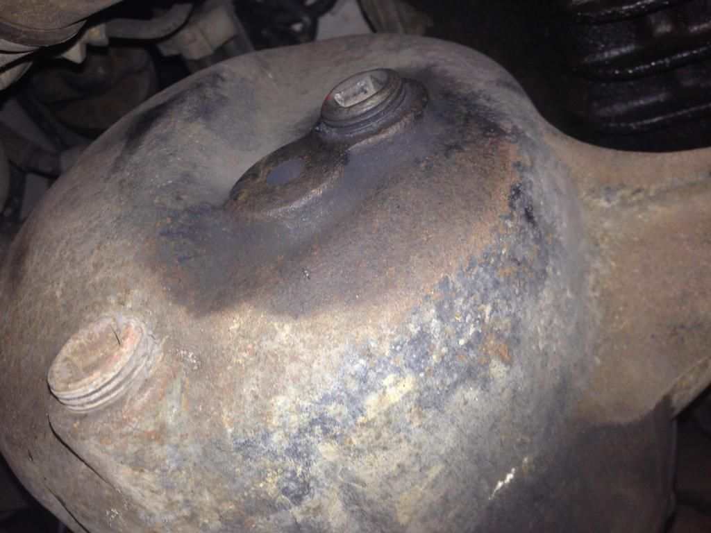

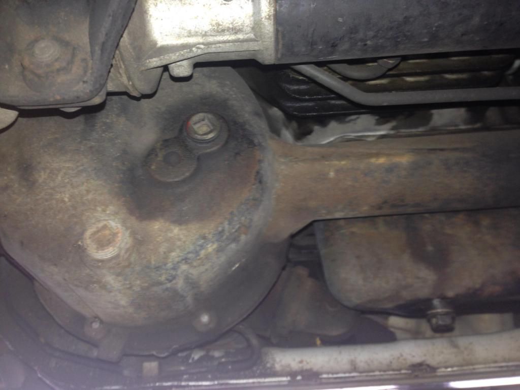

here we go boys, sorry about the crap photos.
Rear Diff
front diff
and a cheeky one of the new ride
Post Posted: Mon Mar 24, 2014 3:40 pm
the rust on it would seem to indicate its steel, wouldnt it?

Post Posted: Mon Mar 24, 2014 4:13 pm
Yeah thats what i would have thought as well as the fact that the magnet sticks to it. But just wanted to confirm it. Also wanted to know which rear diff i have and if an arb air locker will fit the rear diff

Post Posted: Mon Mar 24, 2014 5:16 pm
You'll have a 12 bolt rear diff. You'll need to pick up a vitara rear diff housing and put your ring and pinion into it along with an RD209 locker.
Fronts definitely a steel diff.
