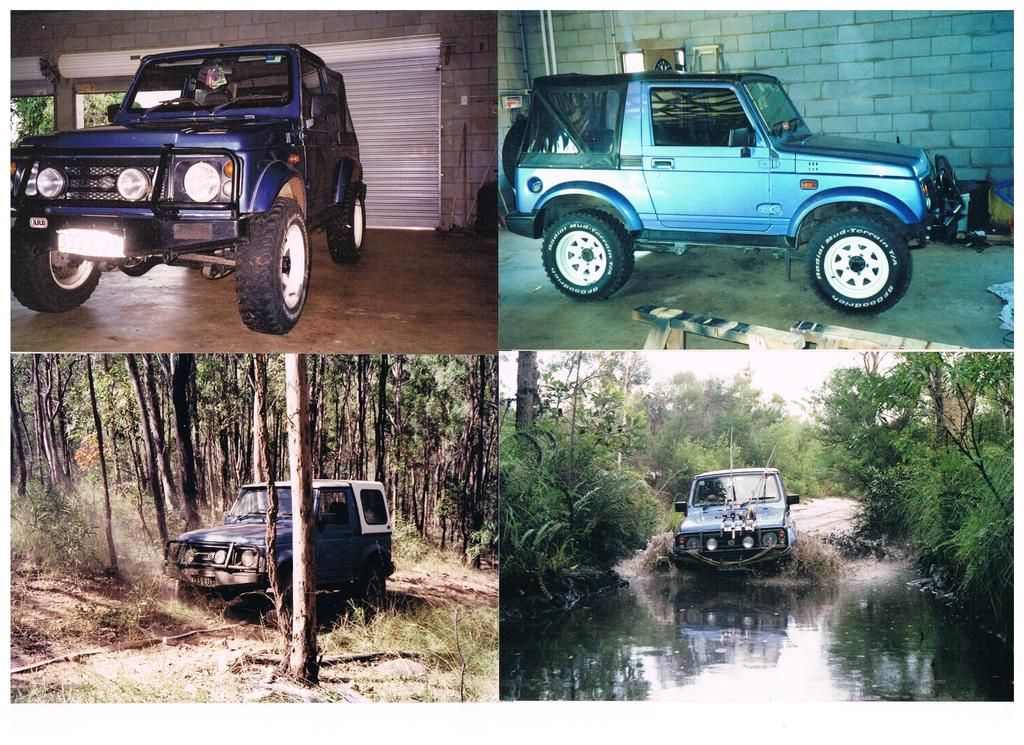

Hi, back in the day I bolted my SJ70 leafy ARB winch bar straight on to my SJ80 coily & simply trimmed (notched) two small sections of the body work below the grille where the bar uprights hit. It worked perfectly, looked great & the bar was mounted to the chassis as intended. My local 4x4 workshop wanted to use brackets & drop the bar down 2 inches, i thought this was a really poor idea, glad I didn’t listen!
[Image][/
P.s. Reinforce the mounting points by welding steel plates to the chassis & use the highest grade steel bolts available. If cutting the outer mounts off for tyre clearance make new outer mounts, don’t rely on just the inner chassis rail mounts! My SJ70 sustained quite a lot of damage after cutting the outers & (surprisingly easily) ripping the bar clean off! Good luck & keep those great little SJ's off their roof's & on the road!
