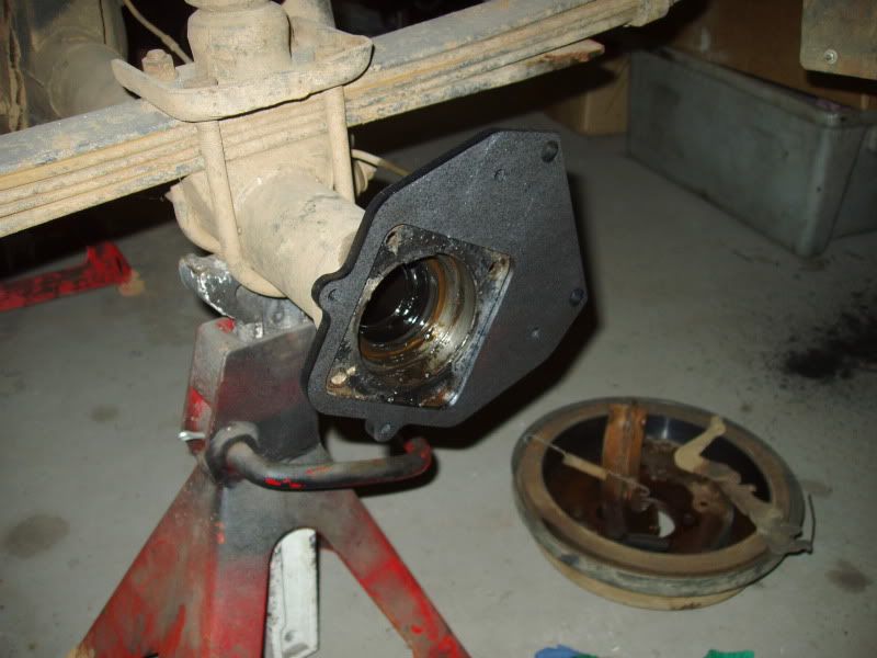

Post Posted: Tue May 18, 2010 11:53 pm
I'm putting R31 calipers on my Zook, with Sierra rotors.
Here are some photos of setup in progress -
Thats some nasty welds

Post Posted: Thu May 20, 2010 6:49 am
jdk81 wrote:
edit: ive picked up a kit from the states to install subaru calipers on the rear. however i am currently undecided if i should install it or not.
the welds will probably still hold, I'm curious as to the grade of those bolts holding the adapter plate on?
Post Posted: Thu May 20, 2010 8:13 am
shakes wrote:
jdk81 wrote:
& how you have mounted the rotor??

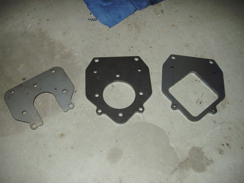

Post Posted: Thu May 20, 2010 9:30 am
soon to be delivered to a few of our members...........
oh....and notice the welds on that spring perch....... :wink:

Post Posted: Thu May 20, 2010 10:29 am
Yep, thay on the wrong side mate.. :roll:

Post Posted: Thu May 20, 2010 10:45 am
Always quality work Joe.
Joes gear makes the american made kits look ordinary.
Post Posted: Thu May 20, 2010 10:53 am
Yes it does..
Post Posted: Thu May 20, 2010 12:06 pm
thanks joe, however all i see is 3 bits of lazer cut plate :D is that for the mitsi
calipers? what do ya do for a disk? and how does it all fit together?
Post Posted: Thu May 20, 2010 12:19 pm
Shep
I think damo did a write up recently of his install (slightly modified) of Joes set up.
The disk is the sierra front disk.
The plate for axle to wheel studs etc, from memory was cut by joe too, or the drum can be machined down. EDIT: I was wrong, not part of the kit
And yes it uses the pintara calipers and cradles.
Little bit of pissing around with the brakelines and brakeline brackets, but it looks the goods.
EDIT: linky to damos write up http://auszookers.com/index.php?name=Fo ... pic&t=3797
