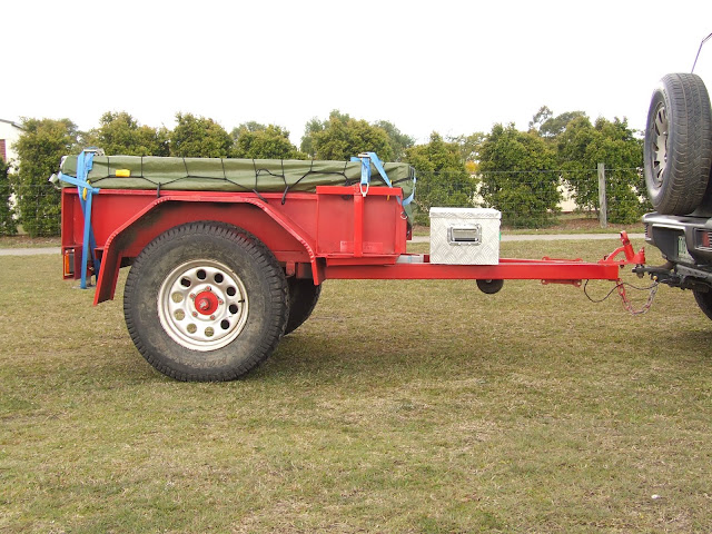

This is the only picture I have of mine at the moment, but its pretty much exactly what you described.
40x40 frame, 1.6mm sides to 450 depth, sierra width on standar rims, 50x75 drawbar, 5'x3.5' and 175kg total weight inc tyres.
Tows great and carries way more than it legally should. :oops:
