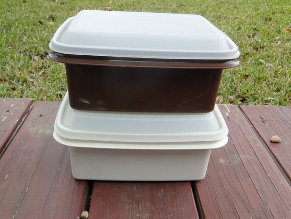

Post Posted: Sun Aug 25, 2013 11:40 pm
Chop wrote:
Sco-tie wrote:
tupperware airbox FTW
Sistema is the new tupperware! :rofl:
Tupperware lifetime warranty FTW!!! Armsup
i was kind of serious... something like this with the lid cut to suit the hole for the air filter & sandwiched between the carby & filter base plate, fit the filter & fit the base over the top, with either holes drilled on the firewall side for it to breath or somehow attach a snorkel to it.

Post Posted: Mon Aug 26, 2013 12:03 am
atari you don't think it will warp with the heat off the engine and oven like conditions under the bonnet?
have had tupperwear sag when left near a hotplate
Post Posted: Mon Aug 26, 2013 12:26 am
:lol: probably, but i want someone to test my theory

Post Posted: Mon Aug 26, 2013 8:57 am
I might give it a go for shits and giggles. I might hunt around for something a little thicker to try and prevent sag from heat.

why not weld something up out of sheet steel will still be light if u make it thin enough, u will need to make it big enough so it can draw air from the space above the car when u smash the loud peddle

Put it in an oven at 90 degrees celcius for an hour, then come back and tell us about your experience :thefinger:

haha my food would now be sealed in plastic :lol: . My actual suggestion remains to find a stock one and mod to suit.
Although I am using a tupperware container as an airbox for my breathers and it is fine, I agree, use something else.

Post Posted: Fri Aug 30, 2013 10:48 am
Ha ha. After. Few drinks last night me and a mate put the Tupperware theory to the test. It's working a treat. I'll try and post a few pics
Nah doesn't look that deep.......fck
Post Posted: Fri Aug 30, 2013 10:53 am
atari4x4 tupperware airbox®
