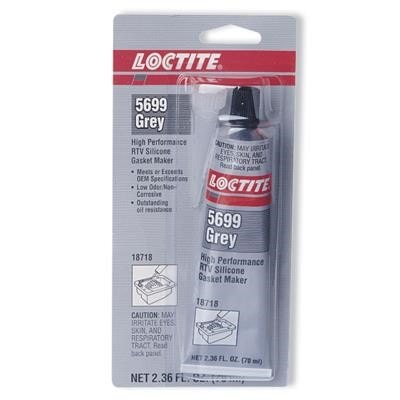

I'm changing my sump gasket and I'm wondering whats the best sealant to use
Posts: 8135
Post Posted: Tue Jul 03, 2012 6:03 pm
Image Image

This threads kinda been talked to death already, but I can vouch for the Locktite product pictured above and comes with clear instructions on how to apply.

No the problem is that there are numerous silicone sealants but not all are designed to be used where oil is in play, if you use the correct one you will not have this problem.
Joined: Fri Mar 23, 2012 11:04 am
Posts: 187
Vehicle: Suzuki sierra
Post Posted: Sat Jul 07, 2012 9:45 am
Could you tell us the right one to use mate.
Posts: 8135
Post Posted: Sat Jul 07, 2012 9:50 am
want33s wrote:
Image Image
:roll:

And these are the ones where oil is in play
Posts: 187
Post Posted: Sat Jul 07, 2012 9:55 am
Sorry I mean and these sealants good for what 2strocker commented before
Posts: 8135
Post Posted: Sat Jul 07, 2012 9:57 am
It says on the packet on the right.."OUTSTANDING OIL RESISTANCE". 8O :roll: 8O
Do you really think I'd recommend you use an unsuitable product?
